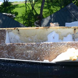

在我们的承包商/屋顶工人和SIP公司多次尝试定义这个问题之后,我们最终引入了我们自己的专业人员。结论是山脊线上的呷口口实际上并没有密封。其结果是热在炎热的日子里流入房子,并在凉爽的金属表面冷凝,如灯箱和风扇箱,所有这些都从内部完全生锈。

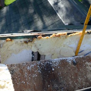

此外,在移除脊峰瓦之后,我们了解到冬季的情况正好相反。即从屋里热空气流出,因为水分不穿透地毯衬到2 x 24“金属肩带的OSB外皮肤和所有紧固件和生锈的他们也腐烂的OSB在许多斑点。
补救措施将包括去除所有腐烂的OSB,并允许任何区域保持潮湿,完全干燥,并更换OSB。此外,建议在顶部去除1.5″的OSB,并将泡沫垂直向下切割到皮肤内部的OSB,并让其干燥。
一旦完成这一点,必须适当地重新密封(?),并以完全通风系统的形式更换完全新的屋顶,并使用透气底层。目前的建议是某种填缝密封胶,将保持柔韧,然后将其专业喷雾泡沫到顶部。
请记住,这将是3″宽约13″高一旦差距打开了推荐。我在网上读到许多强调“带和吊带”的方法来密封SIP脊线(这根本没有发生),所以我的问题是:提出的解决方案是最好的选择吗?

    谢谢你的建议。另一个细节是,在木材框架上,T&G被放置在框架上,然后按照SIP公司的指示,用塑料板覆盖。然后把小口盖在塑料上,拧紧。此外,还有2“x24”的金属带子每几英尺超过顶部,这似乎是焦点的冬季冷凝。然后用罐装喷雾泡沫填充空隙。房子的SIP部分从下面放置T&G,并钉在SIP的内部皮肤。从照片中可以看出,泡沫破裂了,在一边或另一边基本上到处都有缝隙。此外,我们在调查过程中切割了接缝的一侧的几个区域,可以看到在许多地方垂直泡沫深度从6英寸到不到半英寸……或者根本没有封印。损坏区域集中在电线穿过塑料板的地方,以及木框架与房屋的层流梁部分的交汇处。换句话说,在空气容易通过塑料的地方,我们看到的损害最大。 Although there is global rusting of the screws and nails in the SIPs, particularly on the North facing slopes. There is no way, short of removing the SIPs, to put seam tape on the undersides. So what I'm left with is a 3" wide, 13" tall gap if, I go with the current recommendation, that I need to seal. One contractor wants to just foam seal it with his commercial 'high expanding foam' but I pushed back (also on the belt & suspenders approach that I've researched) and want some kind of flexible gasket or suitable caulk that will remain flexible and maintain the seal as my first layer at the newly exposed inner OSB with plastic sheet immediately below it and visible in the base of the gap. Then I would be okay with his commercial spray foam (not cans) above that. I'm really looking for any other suggestions on how we reseal this knowing that we can't get back under the SIPs, but that we will have a new wider gap. As to the other points raised about responsibility, it is being looked into since no one wants to step up to the plate. In addition, the roofer that I am talking with has suggested doing the SIPs repair and then using a vapor permeable underlayment at the ridges and then replacing the Decra for now. This will keep the weather out until we can resolve the other responsibility issues and come up with a long term solution for a new vented roof. I am looking at a standing seam metal roof most likely, but that will have to wait for now.

    我不认为你能用填充物密封3英寸宽,13英寸高的缝隙。我的猜测是,你必须用双组分喷雾泡沫填充沟槽,并依靠山脊顶部的一种剥离粘膜来提供空气屏障。

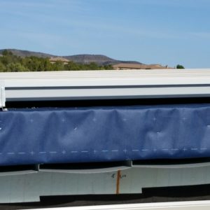

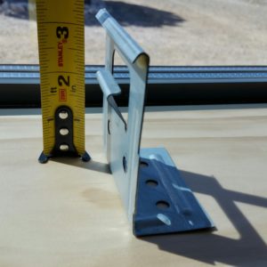

    它们使高低夹子和夹子锁定到金属紫蛋白中。我附上了我的Sip屋顶和MBCI常设缝金属屋顶用紫蛋白的照片。
    夹子将钢屋顶升高约2英寸的折叠。一个警告是,用钢屋顶升高,它往往比标准金属屋顶直接攻击OSB装饰。
