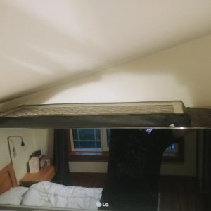

我使用了一个大型标准Merv 8炉过滤器切成两半。这是贴在设备顶部的胶带。大小与顶部的现有开口相匹配。不是最漂亮的,因为您看不到头部高度。

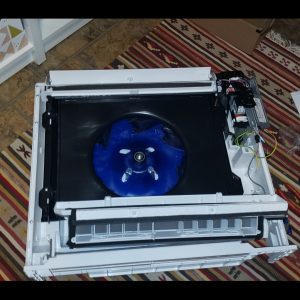

我都一个地板安装单位和一个墙挂载。The floor unit is like 10 times easier to take apart and get to the fan to clean. It is also vastly superior in heating mode as it has an outlet out the top and one out the bottom. Here is a picture from when I installed my floor unit of the fan. The black cover comes off easily with 4 Phillips screws to access the fan.
