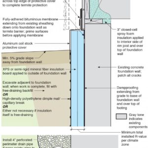

    Some installers sandwich the dimple mat between the concrete wall and the rigid foam. Other installers put the dimple mat on the exterior side of the rigid foam (between the rigid foam and the backfill).
    The detail below shows the latter approach. It comes from the Building America Solution Center.

    Martin, Thank you for the diagram, I have been looking for one all weekend. Do you think the decision to put the membrane on the inside or outside typically depends on the the type of membrane used (rigid/exterior to foam or the peel -n- stick/interior to foam)?
    Martin Holladay||#7
    尼娜,
    Peel-and-stick is not a dimple mat. If you are using a peel-and-stick product, it goes on the concrete.
    如果您使用的是凹坑垫,它可以抵靠混凝土(假设没有剥离和粘贴),或在剥离和粘附和刚性泡沫之间(假设您使用剥离和粘贴),或在刚性泡沫的外侧,如我发布的图示所示。

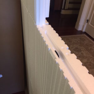

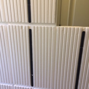

    My vote is to insulate from the inside too. I just went through a foundation pour a few months ago and I avoided a whole bunch of issues by choosing to insulate from the inside. I plan on placing 4" of EPS sub slab and 2 1/2" on the walls. I have been eyeing a product by Insofast and while I see them at all the trade shows, I finally decided to buy some to test it out - see pics. What I like about this product is that it is easy to install, it has electrical raceways built in, and it has plastic studs every 16" OC that you can screw the gypsum directly to so no need to create an interior wall for the gypsum. It is not cheap (pricing is on their website), but it is a DIY friendly product.

    乔纳森,这是一个有趣的产品,绝对值得我研究时间;谢谢。我们打算将板坯的两侧与2英寸的泡沫隔离。您是否会看到使用该产品的任何问题,我们应该这样做吗?

    Martin,我很兴趣地做到你共享图片中所示的(评论#5)。你如何假设凹坑垫被固定?细节在附加的车库底板下面会看起来像什么?
