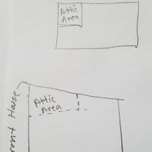

This is my first post and its long.. I attached an image of what I think the current setup of our house is. Until the actual roof is opened I won’t know for sure. I’m also new to all this and the correct terms to use. Zone 6.

    1. Many of your sentences talk about the "front" of the house. Does the front face north or south?
    2. You refer to MDF, but your sketch shows no MDF. Where is this MDF?
    3.您指的是阁楼,但您的草图没有显示阁楼。您能为我们画一个包括阁楼在内的房屋部分的草图,所以我们知道您在说什么?

  4. amz1323||#4
    房屋检查说我们有10英寸的r子。对不起,我忘了添加。
    The siding is T1-11 boards which we eventually will replace or recover.
    The front I am calling is the front of the house which is the south side. The roof is sloped down the north side. Its one large rectangle plane.
    MDF看起来像从上到下的after子上静置。上方的气隙。我看不到MDF顶部从甲板护套上隔开的东西。
    The attic area is small, 6' by 10' or so. This attic area is over a bathroom area only.
    Any idea what the vents from the soffit would have been originally for?

    The description is a little confusing -- but it sounds as if the MDF is a ventilation baffle used to create a ventilation channel. Is there roof sheathing above the 1-inch ventilation channel? If so, what type of roof sheathing -- OSB, plywood, or boards?
  8. amz1323||#8
    Sorry to be confusing, I can only see the roof from the small attic space until its open from above. From what I can tell the MDF is being used as a ventilation channel but I can't tell how its attached to the rafters. There is roof sheathing above this that looks like plywood from the bottom. I made a small hole to look up. I plan to make a larger hole tomorrow to try to see more.
    Whatever the existing roof sheathing is will be replaced completely.
