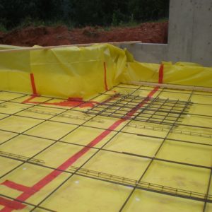

Do I need to tape seams in the vapor barrier and xps that will be under my slab-on-grade house foundation? I read Joseph Lstiburek’s article on concrete floor problems and his assertions regarding air movement and vapor diffusion lead me to assume that overlapping the barrier would be effective since there won’t be much air movement at all under the slab.
Also, tape the xps? I haven’t found much in the way of tape that sticks well to it, particularly if it’s cool and damp out – which is the dominant weather here now.

I agree with Joe on this one -- there is no need to tape the vapor barrier or the rigid insulation panels under a concrete slab.
We've seen surprising amounts of air movement coming up from under concrete floor slabs during blower door tests, we now mandate taping all vapor barrier seams, and then crucially bringing the sheet plastic up from under the slab and taped to the wall air barrier to ensure under-slab air never gets brought into the inside of the house.
Concrete sure doesn't let air move through it, but concrete slabs have a surprising amount of penetrations in them and around their edges, especially with foam thermal breaks at slab edges.
It seems to be moving through the crushed stone and up around slab edges and penetrations, and feels like taping the vapor barrier sheet will at least help close down potential radon pathways.

It sounds like a typical air barrier problems such as drywall. It is the edges and holes poked through the drywall that leak. The concrete poured on the poly will adhere to it. If the seam is at the middle of the slab it is really not going to make any difference. But the gap along the edges or where anything penetrates the floor are the problem areas.
