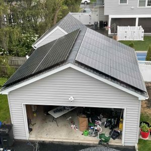

I have a detached garage in NJ zone 4a and I am going to install Tesla power wall lithium ion batteries inside as a home power backup. They prefer to operate in the range 32°F to 86°F (0°C to 30°C) .
The spray foam contractor says that I don’t need any ventilation space between the spray foam and the underside of the roof and suggests spraying directly onto the underside of the roof OSB. What is your opinion? I want to avoid ice dams and roof rot.

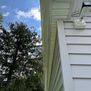

Here's photos of solar panels and soffits

Ok, reasonable enough. However you already have vented soffits. Will the spray foam be applied to block that soffit venting from the inside - which would be sort of unusual. May want to think about replacing the vented soffit with solid soffit so you are not introducing cold air directly to the underside of the roof at the lowest point.
