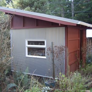

My solution: if you have the space for it, build a separate storage shed. It's much cheaper than adding space to the house, there are no compromises on performance of the envelope or space for stairs of the main house, and it's probably easier to access than an attic.
In my region, a bonus is that mice will find their way in and eat anything moderately edible, nest in anything soft, and poop on everything. Then, if you find time to sort though the aftermath, you have a great excuse to get rid of the extra stuff that you probably didn't need anyway. I'm still working on that last step.

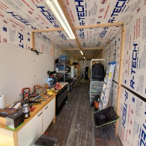

That's what I did too. First an unconditioned one for my tools, then a second conditioned she-shed for my wife's stuff. I was surprised at how much they ended up costing. I guess I shouldn't have been as they include an awful lot of the same things that make house so expensive.
Dry, secure, rodent-proof storage.
It's ugly, and takes up space, luckily we have room so we don't see it from the house.
Having space on the property was key while building the house and pole barn.
Insulation and lights made it more useful, and comfortable to be in. We'll continue to use it for gear storage after the house is done. (climbing, camping, bike, water stuff in the summer; and ski, snowshoe, mountaineering in the winter.) Our neighbor did offer to buy it, I'm sure it has as much or more value now (insulation and lights added by us) than when we bought it.

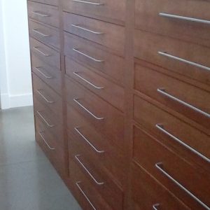

Inside our Pretty Good House, I built in a lot of storage. Window seat in the bedroom has big drawers underneath for blankets, linens, etc. On each side are bookshelves.
The bed isn't against a wall, but sort of in the middle of the room. The headboard is a drawer unit 5 feet tall, with drawers on the side away from the bed. The photo shows the back of the headboard.
In the bedroom, I managed to fit 46 drawers, around 10 linear feet of hanging closet space and about 80 linear feet of shelves. I think built-ins are a very effective use of space, as opposed to free standing furniture.

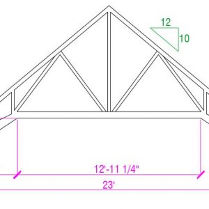

I used a simple modified scissor truss through the whole house, leaving some areas vaulted for extra drama, and putting drop ceilings over bathrooms, closets, etc. creating space within the conditioned building envelope for both storage and HVAC.
