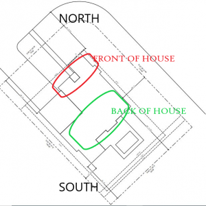

I am attaching an image of the build site with its orientation. We are wanting to build this as an all-electric home to achieve great indoor air quality and avoid emissions from gas-operated fixtures and/or appliances. The only thing is that it would be nice to be able to cook during extreme weather occurrences and power outages.
https://blogs.scientificamerican.com/plugged-in/so-what-direction-should-solar-panels-face/#:~:text=In%20Texas%2C%20the%20current%20structure,demand%20as%20hard%20as%20possible.
2014 article. Not sure how much of it applies today.
'... In Texas, the current structure of compensating for the energy produced by solar panels incentivizes south-facing panels. However, what utilities really want are west-facing panels to hit peak demand as hard as possible. Given the limited daily solar resource, the market calls for something in the middle. ..'

we are in hot and humid TX so probably more concerned of needing cold air in the hot summer than heating for the winter.
