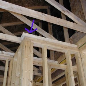

Picture 1: Intersection of two top plates. 1 top plate looks ‘normal’ and I have sealed it (Please excuse mess, I was not planning a photo shoot.) The other top plate is covered by 2 2x4s butted against each other. (These ARE covering a top plate. The wall only goes in one direction.)

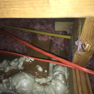

Picture 2: Exterior Wall. Interior edge of Top plate is covered by single boards running diameter of wall. Picture shows a rare gap where wiring is installed (Picture is of non-insulated portion above garage, but insulated areas have this same board.)
-This is the ‘roomy’ side of the attic with no rafters. I’ll be inspecting the rafters later but 1 thing at a time.

    它看起来像顶板上的额外2x4s被用作干墙的背衬钉/拧入。如果你试图撬开他们,你会猜出一些问题。
    I personally would not worry about sealing these as they do not penetrate into the living area and really only create more of a thermal bridge. I would however be sealing all of the wire holes etc. that actually penetrate the envelope.

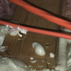

    Photo: only 1 'extra' board on this top plate. One side of top plate covered. Other side of top plate open (and will be sealed). - This photo helps me visualize what's going on under the boards in the other photo. (Can't see the second top plate under the two boards photo since they are covering it.)

    与迈克不同,我会“在这些板之间密封”,即使“它会增加密封的长度〜50%,因为我会做两侧和中间。”
    There are too many uncertainties about what is under those 2x4s, and you aren't going to be prying them up. A little extra time and material spent air sealing is time and money well spent. This is your only chance to get it right.

    I've attached a picture of what it looks like he's describing.
    For my benefit, If it doesn't enter the envelope, why would it need to be sealed? Is this just in case these are not drywall backing? The top plates should have been caulked and or glued together, and possibly even caulked in the gaps. How would any thing leak through these into the home? I can only see air getting between the top plate and backing.
  5. Ryan Magladry渥太华,安大略省||#5
    Seal it, there is still opportunity for air leakage behind/ontop the drywall and around the blocking.
  6. GBA Editor
    马丁·霍洛拉||#6
    麦克风,
    你的蓝色箭头指向钉子。
    我们密封顶板和安装在分隔壁上的干墙之间的间隙,因为空气可以在墙壁上的干墙和顶板之​​间泄漏。
    裂缝上方的钉子不是气密的,因此钉子不能防止空气(其在相对于阁楼的正压下)进入阁楼。我们需要密封木头接缝以及干墙到木材接缝。

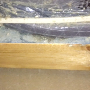

    图片:通过我的阁楼跑的主要摄入量。我可以到达管道内部。(现在在这里放置泡沫和2x4)
