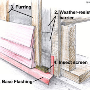

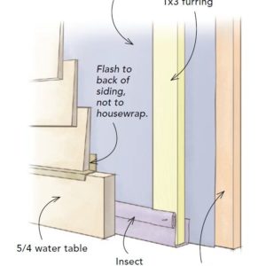

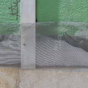

If you still want to use insect screen, I think that 6 or 7 inch strips would be adequate. I'm attaching a few images showing you how other people have done it.
