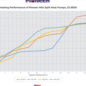

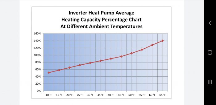

I would spend the extra $249 and get the 24k WYS series. The Diamante WYT units have really poor heating capacity. Here are the Performance charts for the WYT and WYS. The WYT starts losing capacity at 47 degrees and stops at 5 after it lost half its capacity.
Also, for $200 more than the WYS you can get an actual hyper heat Midea Premier that will blow both those Pioneers away.

I don't think that's the right chart - I think that's for the 19 SEER WYS vs the 22 SEER WYS. The AHRI suggests 16200/24000 = 68% capacity at 17 deg F.
Just comparing the numbers on the AHRI it's 16200 for WYT vs 15300 for the 22 SEER WYS.

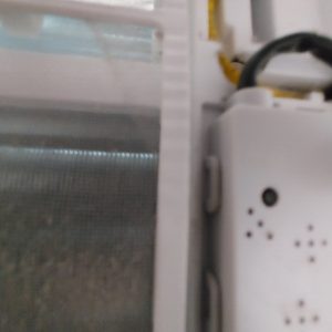

It wasn't too bad with the 12k. Just lift the hood, pull out PCB, plug it into the right slot (CN16) and push it back in again. I didn't take the PCB out, just pulled it out a little bit, plugged it in, then pushed it back.
It did take a couple tries with the Smart Life app for it to pair - I reset the power on the unit while retrying the 6 times. Of course it's always possible a wire is loose some place. There also should be a pin hole some place to get into AP mode. I believe you put a paperclip in the black dot.
