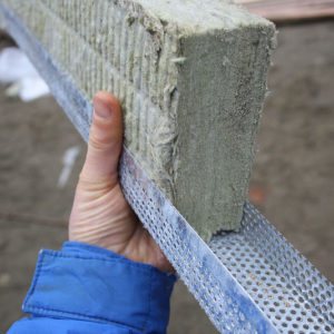

How are those of you using this product detailing the bottom of the wall where the Roxul is exposed?
I noticed on one post about a project in BC, they used a perforated galvanized channel to encase the bottom of the IS. Does anyone know where to source a channel like that?
I’ll be using 3″ Comfort board over 1/2 CDX sheathing, over 3/4″ x 3″ furring strips, then cedar shingles.

Here are 2 links to installing Roxul mineral wool on the exterior. These photos show the J-channel at the bottom of the Roxul. The only company I've found that has a similar product is Menzies Metal. I wasn't able to find that product when we were building our house, so we just skipped it.

http://www.menzies-metal.com/vent-flashings/perforated-j-channel-rain-screen-low-back
Edward,
Show this photo to a local sheet metal shop and ask if they can bend you some perforated galvanized channel that looks like the photo.

It is a lot easier here in BC. Because our code mandates rain screens, most lumberyards stock a variety of widths and as Martin said will also bend up any other custom sizes. Soffit installers also have breaks and might be another place to try.
