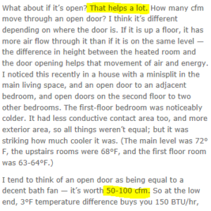

If an open door "helps a lot"
then it follows that a transfer fan could also "help a lot" ... eh?
If 150 BTU/hr is "a lot", then sure, it helps a lot. Mind you, that's less than the heat output of one sleeping human under the covers. That's less than 10% of the heat load of a room with a 2000 BTU/hr load.
Depending on the configuration, a 3F delta-T with 15-18 square feet of open door can buy you more than 100 cfm, and a 10F delta-T buys a heluva lot more cfm. Taking a WAG at it (no real data, just as there was no real data behind Marc's WAG of 50-100cfm @ 3F delta), the heat transfer curve is probably an exponential of about 2 with delta-T- double the delta-T and you get 4x the heat transfer, due to the combination of bigger delta-T and higher flow rates that are induced.
The exponentially higher flow rate with increasing delta-T makes the max delta self-limiting at a dramatically lower point than with a transfer fan. A transfer fan buys you the same cfm independently of delta-T, which is merely a linear increase in heat transfer with temperature difference,
Don't shoot from the hip on this, do the heat load math first, then the napkin math on the delta-T and fan cfm. Don't forget to include the conducted heat through partition walls too, as well as occupant heat (figure 250 BTU/hr per human for a bedroom).

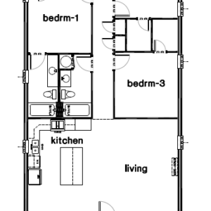

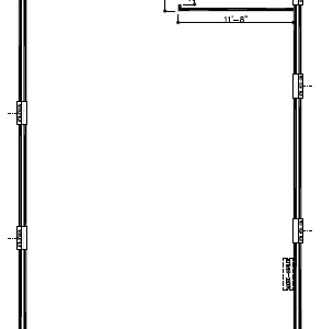

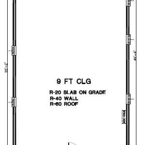

Here's an example Not-So-Big ...
High Performance Enclosure & Windows...
One Ductless Mini-split ....
Climate may vary (probably not Fargo)
What happens when we add partitions... and doors?
1. No Interior Walls ... One Ductless Mini-Split ...No Problem
2. Begin to add partitions but no doors... just a 32" wide x 9 ft tall opening.
Is there a potential comfort problem in the Northeast corner Alcove?
3. Fully partitioned with doors (closed at night)
Likely not-so-comfortable in extreme weather

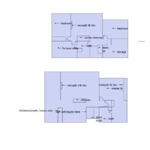

So this fall I did a small experiment that is relevant to this discussion
The minisplits were installed purely for AC, not believing we could get the house insulated well enough to do without a boiler.
I have attached a sketch of the floor plan
2800 foot house circa 1970, 'Deck House" clone raised ranch
750 square feet of glass[!]
spray foamed 2x4 walls
iso foamed roof ~R30
Current fuel use without minisplits 600-650 gallons of oil yearly heat and hot water, family of 4, 69 deg thermostat 24x7
3 Mitsu minisplits, 2x 9k, 1x24k
Because of internal politics I was not able to continue any testing past Dec 1st, bu tit did get into the lower 20's F so I was able to get a good idea of what heating with the minisplits would be like
I was hoping to compare what the cost of heating was like compared to the Buderus condensing oil boiler, but really short of some accurate metering of the units themselves this proved impossible. What I did find out is that I really need to get the shovel out and insulate the foundation walls, as the downstairs, despite being smaller, used much more heat than the upstairs
The downstairs experiment did not make it through november as the bedrooms[doors open] drifted about 2 degrees below the setpoint on colder nights[high 20'sF]and SWMBO objected
The upstairs stayed completely comfortable through November, with no noticeable temperature variations at all, again doors open
When I say no noticeable variation, I mean less than 1 degree anywhere, and I suggest examining the floor plan. The large living room unit has a spot behind it in what we call the kitchen ante room, that is nearly 25 feet away, directly behind it and it was perfect. look also how far and around the corner the master bath is from the bedroom unit, and it was not the least bit cool, and it has 10 feet of outside wall, and 8 feet of 2 foot overhanging the outside[with R9 foam only] as the entire outside overhangs 2 feet in every direction

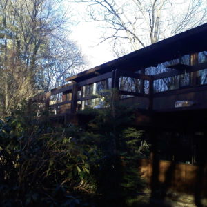

Attached also is a pic of the NW side of the house, in case you thought this was not a stupid 'why did they build a house like this in New England' house.
So my conclusions are that with an open door lifestyle, this setup in this house would most likely be perfect for 80 percent of the winter, probably more and virtually 100 percent with additional foundation insulation and some level of air circulation down stairs. I have no reason to believe that the upstairs would fail to perform at any outside temperature. We in fact had a oil line freeze the first winter at approx zero degrees, and the units performed well for the 12 hours they were required, although I was not paying close attention to details
Now, I think this leads me to surmise that most of the objections to the use of minsplits in a PG or Passive house are not well founded.
