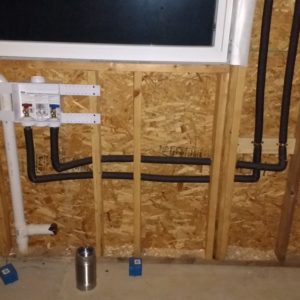

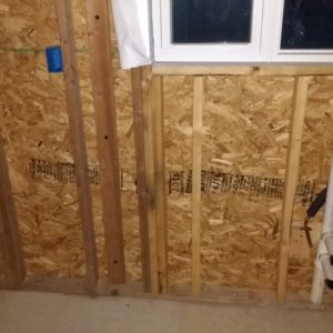

I will say that I do have 2x4 exterior walls with OSB sheathing that is taped at the seams and caulked at the sill and top plates. I have done everything I can with air sealing that I know how including using Quickflash products on all penetrations. If this is going to help with the air tightness, that might be worth it in itself.

Robert,
I have considered the BIBs but I have not found anyone locally (in Waco) that does it. My only concern with BIBs is what the cost would be for me. The house we are building was an existing structure (previous owner started building the house, had exterior walls and trusses installed) and we had to reframe a lot of the outside to fit new window and door locations. With the new framing, I have a lot more studs than a standard 16" OC wall. Also, because of this, I'm thinking the extra Polyiso on the exterior would help with the thermal bridging between the studs and the exterior.
So now I'm back to thinking this would be a benefit and should be done....
