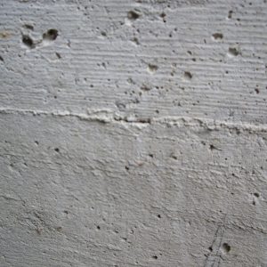

Jim,
I'd wait a bit before deciding. Here is a picture I just took of my board-formed foundation with flat-ties. It's 25 years old.
Thanks Malcolm. That is exactly what I needed to see! I will let them go.
BTW... that 25-year-old wall looks awfully clean. Have you protected it with some type of masonry sealer?
No, that's under the cover of my front porch roof with a slab below, so not much to get it dirty. That corner does see quite a bit of wind-blown rain in the winter though.
