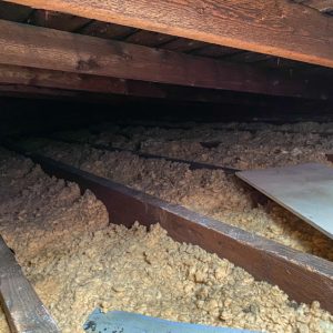

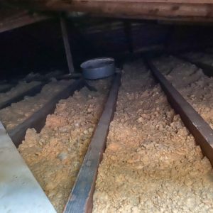

您可以从这两张图片中看到,没有拱腹的地方,屋顶基本上是平坦的。

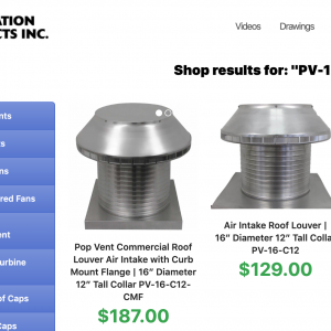

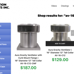

Thanks for responding to my post and questions Michael. A couple vent manufactures recommended I go with gravity vents. One has recommended two intake vents at low points at both ends of the roof, and two exhaust events at the highest point on the roof. Active Ventilation Products Inc is recommending:
>排气
https://frofvents.com/?s=Av-16-c12&post_type=product
>PV-16-C8 or C12 for intake.
https://roofvents.com/?s=PV-16-C12&post_type=product
Does this make sense to you?

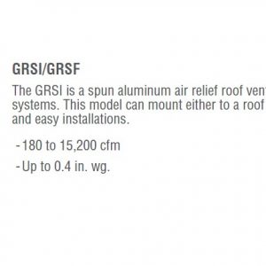

What if I had gravity vents like Greenheck’s GRSI
https://www.greenheck.com/products/air-control/gravity-ventilators/intake-gravity-ventilators并将它们放在顶部屋顶的最低点和顶部屋顶的最高位置?那会起作用吗?这是Greenheck Gravity通风口的外观。这里没有任何旋转。
我对您的热边界目前的位置感到好奇。您在膜下提到Polyiso,这似乎是一种浪费,因为它不会在通风的阁楼上做太多。您是否有阁楼空间,地板上有绝缘层?
There is insulation over the ceiling of the 3rd floor. Our plan is to add additional insulation in the attic. There is a trap door on the ceiling of the 3rd floor, leading to a hatch to the roof. These photos are of the space between the roof and 3rd floor attic. And yes, the insulation under the TPO is a bit of a waste with respect to insulation. I can't remember why we added that. It's possible the roofer thought it would be a good surface upon which to lay down the Firestone TPO.
Those vents are for commercial application where there is fan pushing air out, closer to a range hood cap than a roof vent. You want simple passive vents, essentially a big hole protected from rain.
Depending on how your crown is installed and finished, you might be able to drill holes in it and protect with color matched covers. In your case it is also much easier to add vent area to the peak of the roof, our code allows only 25% of the total vent area to be down low, which would reduce your install costs a fair bit.
