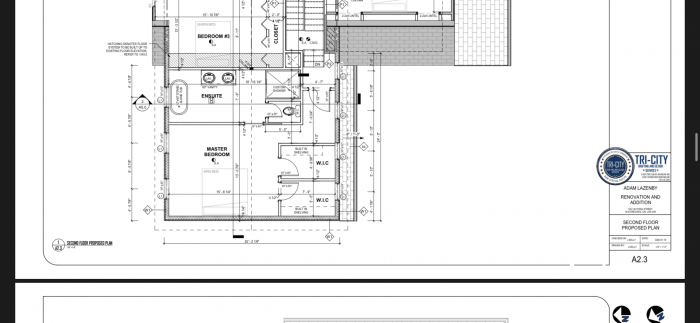

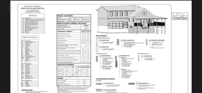

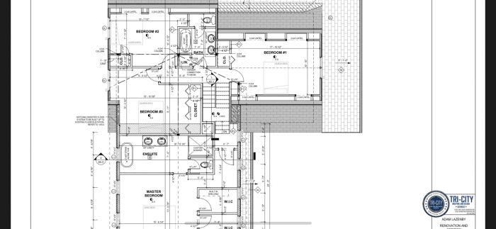

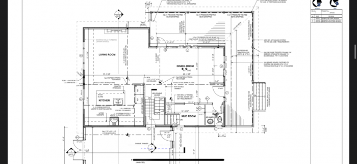

嘿,帮我在找几个想法。我有一个坎e from the 1950s that i am remodeling to live in in southern Ontario. It is about 1500sq/ft with the garage addition. the addition had a master bed bath and walk in closet. The main house will have laundry, bath, mechanical, and rec room in the basement. The main floor is all open except a mudroom and a powder room. The rest of the main floor includes kitchen dining and living. I have attached a few pictures of floor plans.
I would love to put in a heat pump and go ductless but have been told its not too efficient to run here in the winter. We have gas in the house and could use a gas forced air furnace but i’m afraid the bedrooms will not be comfortable. Its also a considerable amount of duct work and is difficult to get to each room. I m also concerned about comfort above the garage. We plan to love there for 40 yr plus so i want to get this right. Any and all ideas would be more than welcome!!!

It's hard to read the floor plan drawings, but looks like a pretty simple footprint to the house.
