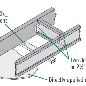

铺设商店照明..一些4'LED带灯。我可以使用附加的方法在他们需要的地方加线我的固定装置吗?I see install guidelines for I joists that say “no nailing the flange” how would these small blocking pieces be secured to the i-joist….wanting to use dense pack after all plumbing and electrical is done so I’m not wanting to create a full blocking from bottom of 2nd floor subfloor to top of 1st floor ceiling.

    下面的插图来自一个Weyerhaeuser发布的安装指南。该图示出现了可以通过OSB网以及通过法兰安装紧固件(因为插图中所示的连续捆绑似乎固定在法兰上)。
