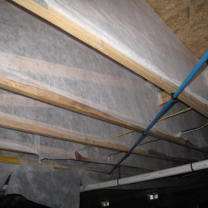

I know of one Passivhaus in Washington state (the Freas house in Olympia) with a crawl space foundation. The Freas crawl space is ventilated, and it has an insulated ceiling (blown-in fiberglass). I am attaching a photo of the floor joists in the Freas crawl space, before the insulation was installed.
Gerald, I've had my insulator do a couple of floors with dense-packed cellulose. We recently did one on open piers, where we installed 3/8" CDX ply under the joists before drilling holes, installing the cellulose, and then covering the holes with plugs. Under my house, where there isn't a way to get 4x8 sheets in, he used a thick fabric he calls "Canvex" under the joists. It is stapled in place around the perimeter and then reinforced with lath strips. It is a LOT heavier than the netting used to blow open walls.
