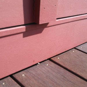

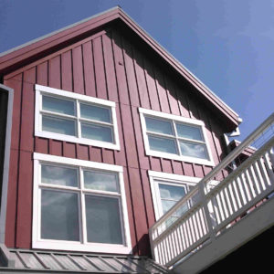

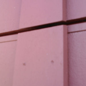

I think our home would be the Hardie panel "country look" as Armando describes it. However note that we still utilized Z-flashing at the horizontal panel intersections and at the bottom rain screen vent. Top rainscreen vent (Cor-A-Vent) is covered by a frieze board. Snapped some quick pix.
