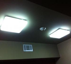

Laura,
I have no idea whether your ceiling is flat or sloped. Nor do I know whether you like modern-looking light fixtures or traditional designs; nor whether you prefer rectangular light fixtures or circular ones.
Below is just one example of a surface-mounted fixture. There are hundreds of styles to choose from. Visit a lighting showroom and choose one you like.
