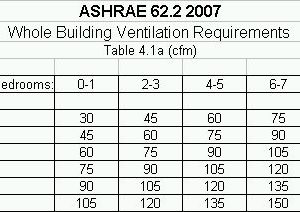

    Whatever ventilation system you choose, it should meet the current ASHRAE 62.2 requirements of 15 cfm per person.
