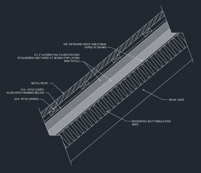

If I am going to install bedrooms in essentially the attic again what the best way to insulate it?
After some reading I was leaning towards external polyiso foam with batt insulation in the rafters. Detail attached below. My concept should yield about an R52. There are many article on foam over roof sheathing but after much searching I failed to find a detail like the one I have put together. And possible for good reason… and that’s why I am here.
Most details show a second layer of sheathing on top of foam, then the roofing material. My question is if I install a metal roof could I eliminate the second layer of sheathing? Install furring and 2×4 purlins instead of the sheathing. It seems to me that there would be the cost savings on the sheathing that would be better served on a metal roof and the ventilation under the roof that this design would allow.
Or is it more cost effective to install the second layer of sheathing and asphalt shingles?
Let me know if you see issues with this approach or any other feedback.

I don't see anything wrong with the concept of no second layer of sheathing but, in my opinion you can rely on the air space in the ribs of the roofing for your "vent" space and eliminate the vertical 2x4s (assuming a screw down roof). You're going to find it tough to find the framing below with screws through 6" of insulation.
It's probably cheaper and better to go with a "plenum truss" approach, where there is a service cavity for the ducts & air handler, and the vented attic can be insulated with blown insulation.
//m.etiketa4.com/article/use-plenum-trusses-to-keep-ducts-out-of-your-attic
https://www.finehomebuilding.com/membership/pdf/72033/021233086.pdf
https://www1.eere.energy.gov/buildings/publications/pdfs/building_america/measure_guide_plenumtruss_air_distribution.pdf
The cost of the trusses are higher than a simpler truss or raftered roof, but the rest becomes cheaper, a LOT cheaper than insulating at the roof deck.
Without the sheathing above the insulation, is there any issue with attaching the roof underlayment? It may be difficult to secure to the insulation unless it is a peel and stick product that's compatible with your insulation. Your detail doesn't have any underlayment aside from the zip sheathing, which is under the insulation. Are you expecting your taped insulation to function as the underlayment? Will your metal roofing supplier approve/warranty this installation method?
