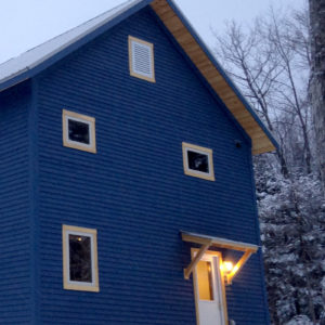

Sounds like you've gotten some good advice and have a plan for the ceiling barrier. I'll pass along what we did for our house (zone 6, NH) in case it's helpful, particularly for the venting...
We have an unconditioned attic with 20"+ of cellulose on attic floor. The ceiling air barrier is continuous 5/8" gypsum on strapping, installed before interior partitions and before interior stud wall (double stud wall). Only two intrusions (one plumbing vent pipe and one solar conduit), well sealed. We also used 3M tape on the gypsum to exterior stud wall top plate transition. Overall, I'm confident this barrier is keeping conditioned house air out of the attic.
Because of this, we are only using gable vents (fixed on west side and larger hinged on east side for access) and the soffits are totally blocked off. Some inspiration and advice for this came fromUp Hill House.
Hinged gable vent:http://www.customgablevents.com/Hinged-Gable-Vents.html
This worked out well (much easier than dealing with soffit vents) and we are happy with the gable vents from that company.
Wow, Brian, I am super inspired by this. I assume you have a ridge vent. What do the energy gods think of no soffit vents? Would large gable vents provide the needed air flow to cool the roof? Blocked off soffits? Hmmmm... Sounds ideal if it would work. Nice color by the way. I am doing similar with light gray trim and black Marvin windas.
Just a first time homeowner here with no experience before this project, so keep that in mind...
No ridge vent. The larger hinged vent is 24x30" and the smaller fixed is 24x24", both have nailing fins. The space between the trusses, above the top plate, and below the roof sheathing is blocked by wood by the framing crew....we added the foamed XPS to further seal this area and the cellulose from wind.
I don't think the concern is so much the actual roof temperature (our roof is 5/8" Advantech sheathing, felt, strapping, metal panels), but the attic space. I believe the consensus is that with a very well sealed/insulated building envelope, there isn't the need for much attic ventilation.
I've been in our attic a lot in winter and summer, it's dry and things seem fine. 24' ladder is just enough to access.
