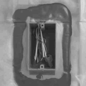

细节的法兰密封聚乙烯an airtight electrical box vary from manufacturer to manufacturer. The manufacturer of Airfoil airtight electrical boxes, Doug McEvers, suggests that polyethylene should be sealed to the box flanges with Tremco acoustical sealant. (See photo, below.)

If your electrical boxes and recessed lights include foam gaskets, the gaskets are designed to seal air leaks, without the use of Tremco acoustical sealant. However, these gaskets don't create a perfect seal, and air leaks are still possible, even with the gaskets. That's why you still might want to use Tremco at your electrical boxes, and why you still might want to avoid using any recessed can lights.
To seal the MemBrain plastic vapor retarder to the flanges of the Airfoil boxes in my house, I started using an acoustic sealant, but I found that the bulge of the dense-packed cellulose was lifting the MemBrain off the flanges. I cleaned the sealant off the flanges, trimmed the MemBrain back to expose half to 2/3 of the flange face, and applied four strips of good quality tape, suitable for the two plastic surfaces. That worked well, so I used the tape throughout the rest of the house. The tape remained adhered, was of course not messy to apply, and the time per box was fairly short.
