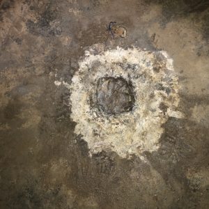

谢谢for the idea. One issue is that the drain was already “sealed” with some sort of cement-like compound. See photo, which I just took after removing the water again. Looks like it was meant to be a permanent fix. Guess I could try adding another layer.
You may be better off cleaning out what there and setting some hydraulic cement or other sealant deeper in the hole, rather than a skim seal.
It seems like investigating where the drain leads would provide some clues. Tough to tell what's going on from on-line. If it seems to be ground water, perhaps treat it as a basement with similar water entry remedies used for basements.
If you can, try to monitor the area to see if that is where the water is truly coming from. If it is, break out the old concrete to see what you are dealing with, then either a mechanical plug or hydraulic cement as Tyler mentioned.

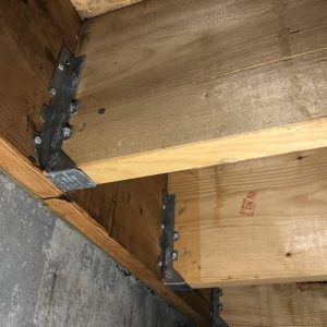

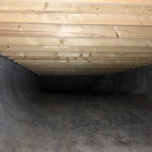

I took some pics of the floor assembly, attached. It is not a flying floor but 2x12s connected to joist hangers connected to 2x12 ledger board, with an additional run of PT wood between that and the concrete. An AdvanTech subfloor sits on the joists.
Apart from the persistent puddle in the deep end, I haven't noticed any other issue with the pool structure itself such as cracks.

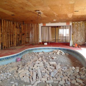

迈克尔 - 我也在参加为期10天的审判,所以我们必须尽快弄清楚。只是为了娱乐,这是我们“池”的当前状态!
