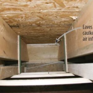

You can make the rafter bays as deep as you want. The depth depends on your placement of the 2x4s with respect to the 2x10s -- the gussets span the gap. See the photo below. (The photo comes from this article by Dan Kolbert:Building a Tight House. There are more details in the article about creating deeper rafter bays with 2x4s and gussets.)
I see, so the 2x4 doesn't have to be flush with the rafter. That makes sense. Thanks!
Jason,
One more point: The photo I included shows caulking that was installed in the blocking between the joists. That caulking makes clear that these are unvented rafter bays -- a method that (I think it's safe to say) even Dan Kolbert, the author, might think twice about before trying again.
These days, the consensus is that rafter bays insulated with cellulose need a ventilation gap between the top of the cellulose and the underside of the roof sheathing. That means that you need ventilation baffles, an opening in the blocking between the rafters, soffit vents, and a ridge vent.
