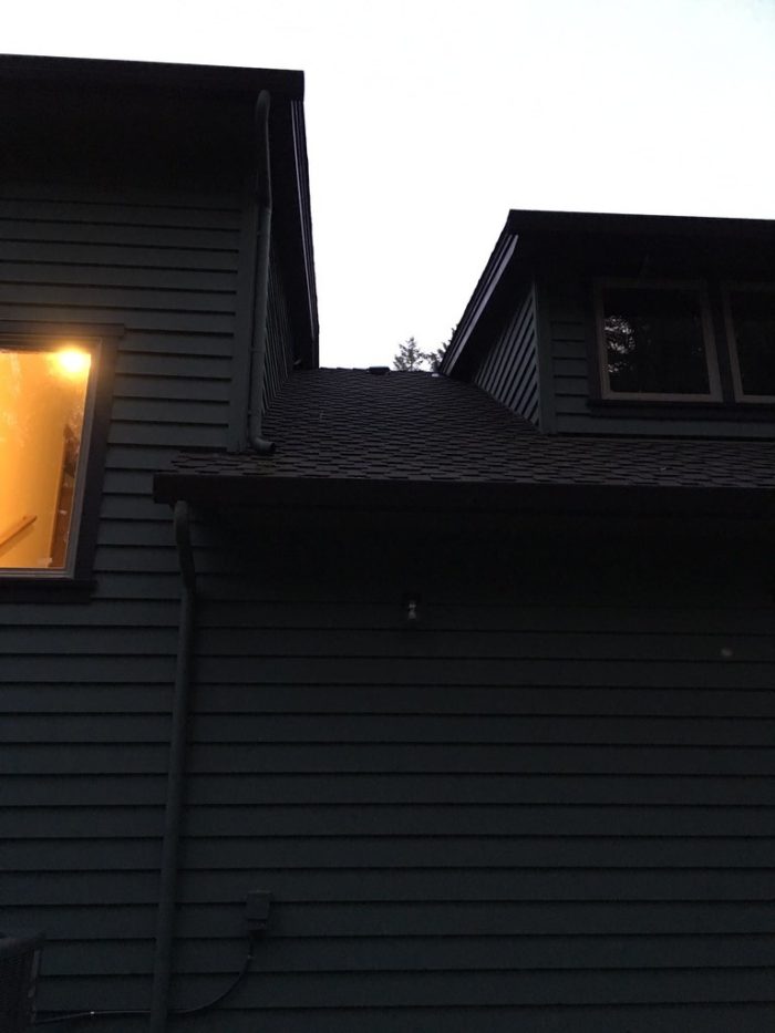

I have an existing house, about two years old. The second story is made up of two dormers, a bathroom, a “bonus room,” and some “usable” attic space (outside building envelope).
The second story gets much hotter than downstairs (8-10 degrees in hot days). I’m interested in whether there’s anything we can do to address that, short of cranking the hvac.
Photos attached. The external shot shows one of the dormers. To the left of it is the upstairs bathroom (behind the middle section of the roof there). To the left of that is the stairwell, with the window.

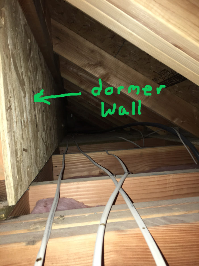

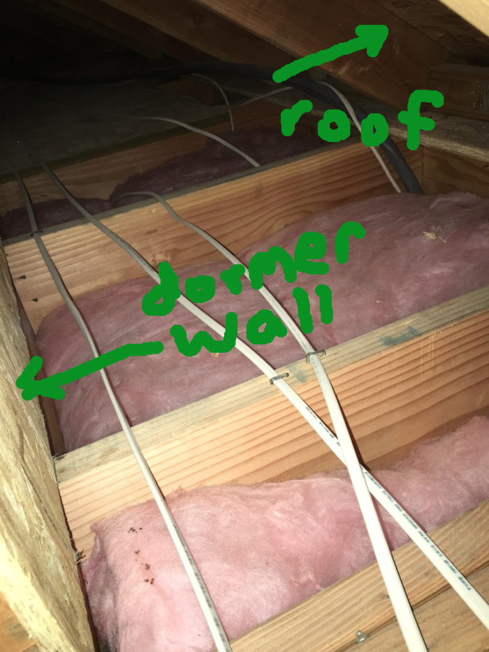

In the bathroom is a built-in cabinet, which I’ve removed to give me access to the “attic” space behind it and in front of the dormer. The other side of the house is similar, except no bathroom.
There is no insulation under the roof decking itself. The floor is insulated with batt, as is the dormer wall. There are soffits in each truss bay running up to roof vents.

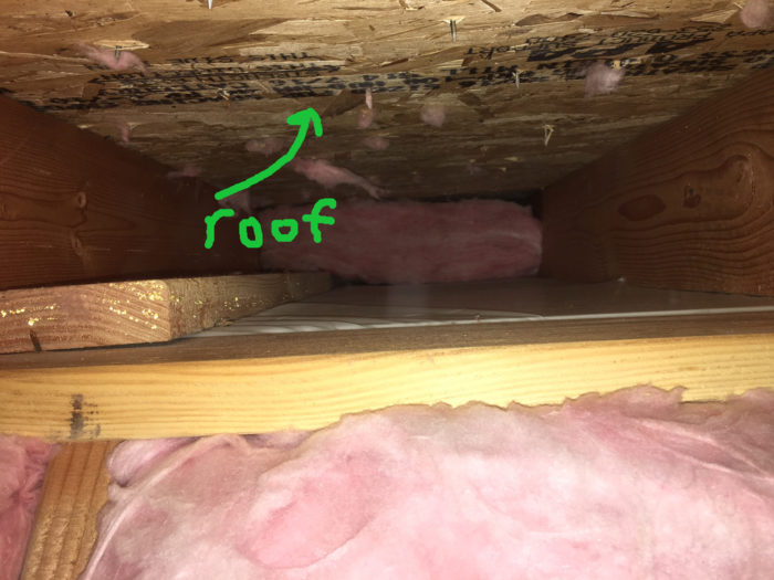

I noticed is that the bathroom ceiling is insulated with batt, but it’s completely filled — there’s no air gap up to the roof vents. That’s the photo with “roof” labeled. I removed the batt that was in there for this photo. But you can see how it extends farther up.
So… at least in this area, any suggestions? I’m wondering if adding a radiant barrier to the roof bays would make any noticeable difference.
或者,有没有可能主要问题是罗依of venting? Should I consider adding thinner, rigid insulation to the ceiling above the bathroom to maintain a better air channel from the soffits to the roof vents?

Maurice,
The main reasons for the overheating are probably that your house lacks a well-defined air barrier -- in other words, the thermal envelope is leaky -- and the R-value of the existing fiberglass insulation is probably too low.
You're right that it's a code violation (and risky from a moisture perspective) to install fiberglass batts between your rafters without also installing a ventilation gap between the top of the insulation and the underside of the roof sheathing. Fortunately, in your case, that flaw does not appear to have yet resulted in any moisture accumulation or mold in your sheathing.
Correcting flaws in the air barrier are tricky but possible. You can do what you can. Improving the R-value of the insulation is more difficult, and probably will have to wait until your next re-roofing job, when rigid foam could be added on the exterior side of the roof sheathing.
Ideally, the triangular attic behind your kneewalls would have been included in the thermal envelope. If you want, you can install insulation in the sloped roof assembly above this triangular attic, using either spray foam or ventilation channels and fluffy insulation. For more information, see“Two Ways to Insulate Attic Kneewalls.”

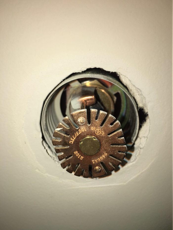

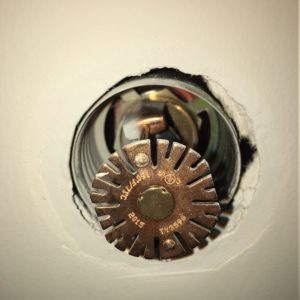

Any experience with sprinkler systems? We have these peppered throughout the house. They have plastic "tenting" over them, under the fiberglass insulation.
The tenting doesn't seem to really be sealed though. It just overlaps the sprinker a foot or two and is sitting on the ceiling framing, AFAICT. Since fiberglass doesn't prevent airflow, this is probably a significant source of leakage?
Maurice,
Yes, sprinkler heads are frequently a source of air leakage. The example in your photo is certainly leaky, and needs some caulk or spray foam.
For an in-depth discussion of this issue, seeWasting Energy or Catching Fire.
