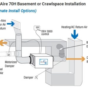

I am building a 6000 sq ft house in Alabama. Downstairs is about 4000 of those sq ft. On one of the two A/C units downstairs, we are installing a whole house dehumidifier. My installer will install however I want but he typically pulls air from the return trunk, and returns into the supply trunk bypassing the air handler. Is this the best way to do it?
I’ve read some prefer to have a dedicated vent in the house to pull in air to WHD and then return to the supply trunk after the air hander. Thanks.

Back to my original question - how should it be ducted and why?

Does anyone have a substantive answer to my question? I'm sure there are several ways to duct a WHD that won't void a warranty. What I'm asking is for the preferred way to duct a WHD and why?

3. If you want to buy a whole house dehumidifier, follow the installation instructions provided by the manufacturer. The illustration below comes from the installation instructions for the Therma-Stor Ultra-Aire.
-- Martin Holladay
