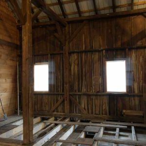

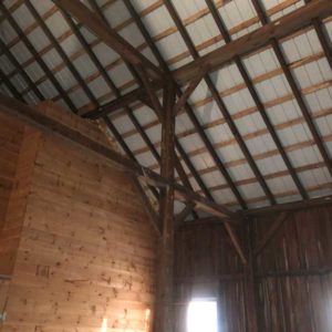

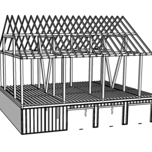

谢谢大家的想法。我正在努力创建该地点的3D模型,但与此同时,这里有一些照片。

Thank you all for your thoughts so far. I'm working on creating a 3D model of the place but in the meantime, here are some photos.

Also interested in thoughts on sealing and insulating the roof. It is a corrugate galvalume metal roof screwed to 1"x4" oak purlins (24"oc) on 3x5.5" rafters (~30" oc).

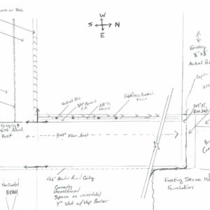

Quick sketch of wall/floor details...
At this point it seems like the way forward may be to apply girts between posts to create a gap, adding tar paper or Tyvek inside these girts, attaching polyiso to the inside of the girts/paper and sealing with tape/caulk. Then build interior wall framing inside of the sealed polyiso insulation. I guess the rain screen layer will not be able to get between all existing framing members for total drainage in the conventional sense, but should be able to prevent moisture that gets behind the siding from migrating inside. Make sense?

Your plan for the walls would work. It would make sense to specify rigid foam that meets the minimum R-value requirements described in this article:“计算刚性泡沫护套的最小厚度。”
If you use the same approach for the roof assembly, the riskiness of the finished product will depend on whether or not there is a good vent channel above the insulation. Ventilation makes the assembly more robust. It sounds like you are considering either a continuous layer of rigid foam, or a mash-up between rigid foam and flash-and-batt.
如果您最终没有通风渠道进行操作,那么遵守闪光灯和击水的无通风屋顶组件的规则很重要。更多信息在这里:"Flash-and-Batt Insulation."
