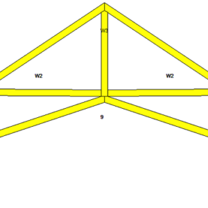

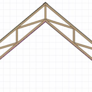

    你有剪刀桁架(如下图所示)还是平行弦桁架(如下图所示)?
  8. 用户- 7034059||#8
    马丁,这是平行和弦,放在原木墙上。计划把桁架的末端像墙一样绝缘

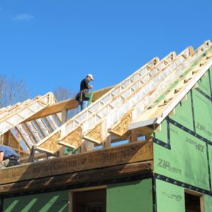

    If using foam board or fiberboard for the exterior air barrier with dense-packed fiberglass/cellulose, it has to be supported mid-way between 24" o.c. trussed to keep from bowing and restricting the vent path. A 1.5" wide strip of foam board of the right thickness for the channel depth adhered to the underside of the roof deck adjacent to each rafter and mid-way between is sufficient.
    克里斯·斯特拉顿(Chris Stratton)和文·李(Wen Lee)并没有采用密集的填充物,而是使用硬质泡沫塑料作为隔热垫的外部空气屏障,在每根椽子旁边用泡沫塑料条来建立通风口:
    https://static1.squarespace.com/static/5565e96ee4b032025ebab985/t/5a9763bac83025ddb3c4d848/1519870911322/diagram+insulation+ceiling+post.jpg?format=750w
    https://static1.squarespace.com/static/5565e96ee4b032025ebab985/t/5a5ed94053450ae875f97fc4/1516071174379/IMG_4513.JPG?format=750w
    (图片来自“节俭的快乐”博客页面:http://www.frugalhappy.org/blog/2018/3/11/insulation.)
