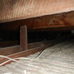

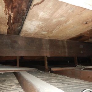

非常感谢!我的屋顶是一个“橡胶火炬屋顶”。To my knowledge the roof is unvented... it is a townhome with other homes attached on the right and left. I've attached a few photos here of the attic.
How old is the roof? Your other class of options is foam on top, a fire barrier, then a new TPO roof.
看起来您有足够的深度。
联排别墅的建设日期是什么?该行中的其他人隔热了吗?
Construction date is 1922, new roof was put on in 2017 so won't be doing that for a while. I think other folks have insulated, but not with a concern for green building techniques.
是否可以爬到该阁楼空间?
It can be moisture safe to do a hybrid approach with a few inches of closed cell foam directly applied to the underside of the roof deck, with the remainder being cellulose. In zone 4A as long as at least 30% or more of the total R is closed cell foam the cellulose stays pretty dry, and the roof deck is protected. If those rafters are full-dimension 2x10s (true 10" nominal cavity depth) installing 3" of HFO blown closed cell foam (R20-R21) with 7" of cellulose blown in netting (R26-ish) you'd have R46 total, with foam-R ratio of R20/R46= 43%, which is PLENTY of dew point margin. With only 2" of HFO blown foam (R13-R14) and 8" of cellulose (R30) you'd be at about R43, which would be at the bare-minimum ratio of only (R13/R43=) 30%.
Loose blown foam on the attic floor would fit, but would all but guarantee high moisture content in the roof deck, along with a lot of moisture cycling in the cellulose which causes unusually high and rapid settling compared to how it behaves in a properly vented pitched-roof attic (the "humidity can wear away the cellulose within 7 years” issue the contractor was warning about.)
Unlike open blown cellulose none of this is cheap. In my neighborhood the 3" of HFO blown foam would run north of $4 per square foot, and 7" dense-packed cellulose in netting is also >2x the cost of the 13-15" of open blown cellulose it would take to hit R49 in a better vented attic. Re-roofing and installing a continuous 6-7" of 2lbs density roofing polyiso (R34-R40) might not be a lot more expensive, and would meet code min on a U-factor basis by not having thermally conductive rafters passing through the insulation layer, and the roof deck would stay dry & rot free, since it would be fully inside the thermal envelope of the building.
