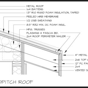

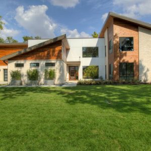

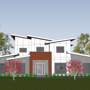

Monopitch roofs are the easiest to insulate, see detail. When it come to aesthetics, its all a matter of opinion. The attached pics shows a roof style that has become "IN" in the North Texas area. I'm sure this style would not go well in other areas of the country.
Both of these houses are custom Zero Energy homes, one finished and the other under construction..
Armando,
It's not clear to me where the air space is for air flow on the insulation detail you provided?
Or is this an un-vented roof? I assume not since the soffits are vented.
Is the detail the same on the high side? If so, any concerns with driving rains entering the vented soffit which is sloping upwards on the high side?

Chris Harper,
Armando's detail appears to show an unvented roof assembly. Some builders like to install ventilated soffit material, even when there is no ventilation channel in the roof assembly. The ventilated soffit material is basically decorative, and the openings are harmless.
For more information on different ways to create an insulated unvented sloped roof assembly, see these two articles:

克里斯-马丁说过,这显示了一个细节unvented attic assembly. The 36" overhangs are ventilated, since we live in humid zone, plus if it ever gets wet, it has a chance to dry.
