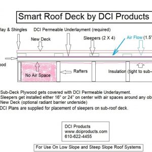

Hi there! Just some interesting facts to share with the readers of Green Building Advisor. DCI Products has many innovative products to share as well as manufacture and some yet to create. This one article about the double roof system ventilating over the original roof deck seems to be identical to a patent that DCI Products president owns since 2015. After spending time developing this concept and working with the patent office for years, DCI Products president, Jack (John) Henderson received a US patent for this exact concept. He has been offering to do seminars regarding the benefits of this system and has been advertising athttp://www.SmartRoofDeck.com这明确显示了专利所有权。公关oprietary products manufactured by DCI are specified for use with this system. Using competitive products without permission from DCI is called “Patent Infringement”. I would suggest discussing the products to be used in this energy efficient roof system with DCI, so the correct ventilation products and the original inventor is on record. Just a heads up since DCI has rightfully offered this system to architects, builders and to the marketplace since 2015. This can be verified by going to the website:http://www.SmartRoofDeck.com

It appears that your claims are specific to shingled roofs. I guess that's because ventilation above the deck has been done for a long time on metal roofs?
I took a look at your web site, but didn't find what products you are selling. What products does one need to buy from you to build like this without, in your view, infringing this patent?
Thanks Charlie!
Receiving a US Patent is a very tough thing to do and costly. Once received it is the patent holder that needs to protect it. The description part Column 1 lines 20-30 of the patent states shingle roofs include metal shingles, sheet metal, roll roofing, cementitious, clay, asphalt, slate, etc. Check it out on the site. Metal roofs generally do not have a primary roof deck and a sub-roof deck. They have sleepers installed for support. The SRD patent has an air & moisture permeable underlayment on top of the sub-roof Wood/OSB/plywood decking that also sheds water (condensation) yet breathes. The Primary roof above has OSB/plywood with an option for a radiant barrier attached to the lower side of the primary deck for radiant barrier protection (Florida, Texas, etc.) and superior energy efficiency. DCI sells plans, specs, intake ventilation, ridge ventilation, permeable sub-roof underlayment and permission to use the patent on that particular project project. Hope this helps clarify your questions. Thanks!
So you are specifically claiming anything with two decking layers, and with a vapor permeable membrane on the lower layer. And the use of the upper decking layer is how you distinguish from prior art using metal roofs.
I can't off hand put my finger on a specific prior example that combines those features, but it seems pretty likely that someone motivated could find one. And the constellation of similar designs, and books explaining the concepts, might make an obviousness argument hard to defend against.
In addition, finding cases where people have done this to go after them for infringement will be really hard. It is more feasible if a large company is making thousands a year. It can then be worthwhile to go after them.
So it might be easier to defend a patent on the special components, if there is anything special about them.

Your patent claims are clearly limited to the sub-deck and membrane on the sub-deck being vapor permeable. Neither the claims nor the specification limit the type of insulation below there. So the documented prior art is included by the claims. I'm afraid that means the claims are not valid.

Furthermore, the requirement is to have vent channels between an upper roof deck and the water resistant sub-roof deck created by adding structural ‘sleepers’ which are installed allowing ventilation channels to properly vent skylights, chimneys, hips, valleys, etc. Sure, many roofs have foam insulated panels with vent channels (chutes) above but the DCI patent expressly states the insulation, sub-roof and the water resistant sub-roof upper surface all be moisture permeable with air channels above yet below the primary roof deck. The primary roof deck can be virtually any slope and any roofing material.
The on-site manufactured double roof system allows for all these key elements to happen. Vented nail base products cannot be made waterproof on the lowest panel below the upper shingle base. That would be impossible to accomplish.

DCI Response: The detail referenced in the article has a ‘Sarking’ membrane above the rafters (no sub-roof deck) and a vapor and air reducer on the.... heated side of the rafters...., fully detailed. (This was published in the article you have just referenced). These details are not part of the DCI Patent. This detail does not reflect a walkable, supportive, moisture permeable sub-roof deck nor the fact that moisture must permeate through the insulation and into the vented air channel. These are critical areas of the patent and not a moot point. Although, it is possible these were added after 2018, when DCI was actively in it's third year of promoting the new energy efficient roof system to builders, architects, engineers and contractors, but as stated 'vapor diffusion' information was added.
In summary, the USPTO office, as well as our professional patent attorneys, did a thorough investigation of all the claimed elements worldwide and found no prior art. I only want the readers to understand the effort we have gone through and the positive results which have been achieved in doing our due diligence. It was never my intention to discredit anyone but when other products outside of DCI are being specified and used to create another person’s invention, something must be said. It is the American way. Please forgive me if I have crossed the line but the truth be told. We have invested millions upon millions of dollars to the Roofing Industry to try and make it better and are only bringing inequities to the public's attention. God Bless Everyone and Godspeed, Jack Henderson, President, DCI Products

DCI's goal to this SRD roof system was to create a 100% sealed building envelope and to vent the attic space moisture and air through permeability. Our goal was to indirectly create an energy efficient conditioned attic space, where the heat is dissipated out the configuration slowly but effectively with the moisture. There are no requirements to seal the cracks between the attic and living area as long as the building envelope is 100% continuous. We have test results on our SRD system to prove that the humidity levels are stable and the temperature levels are as anticipated but not by the comparisons that you have mentioned. This is because our goals were not to allow outside weather to enter through the building envelope which would bring in fluctuating temperatures and moisture levels of various readings. We have a 100% controlled system by incorporating the existing levels of comfort according to each individual homeowner. What we are working on is the recording of the energy efficiency savings of a controlled attic environment verses a fully vented attic. By using baffles within the envelope, external weather is being brought in which lowers the energy efficiency. One thing to remember, when dealing with attic soffit to ridge ventilation, is the primary roof system above basically has no air or moisture permeability because metal or asphalt shingles are nailed above and most underlayment that breathe will not breathe when asphalt shingles are applied directly to the 'breathable' underlayment.
