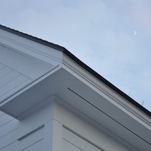

Also, take the No Pork Chops or "bird boxes" pledge.
The thing about bird boxes is that they don't look as good as classical returns, but they also don't allow places for birds and squirrels to rest. For that reason I prefer bird boxes. When form and function conflict, I will always choose function. Engineering is more important to me than architecture.
From a purely practical standpoint neither bird boxes or classical returns work as well as ending the soffit at the wall plane.

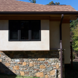

That freise board may look better not interrupted by the window head casing. Underground utilities would help a lot also.
I agree. See my post #6. For some reason the owner decided to paint the window trim a different colour interrupting the frieze board. The switch to an electrical mast also caught me by surprise.
I don't love it but it is better than a bird box.

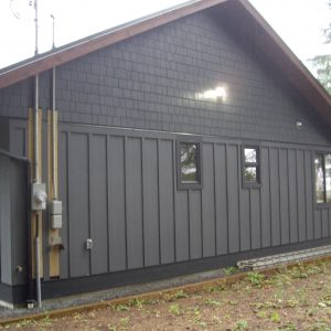

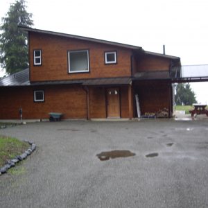

One aspect of house design that doesn't get much attention is that there is often a fairly large difference between what a designer draws and an owner builds. A good proportion of the houses I've designed have had large alterations during construction - with unintended consequences. I always stress to clients that while it's their house, and they are of course free to built it any way they want, it's a good idea to call me first so I can point out the implications of the changes they are thinking of.
As an example, this house was designed with corrugated metal as the cladding for the second storey, and during construction the placement and size of the windows was changed. When you look at it, something seems off. The changes are a large part of why that is.

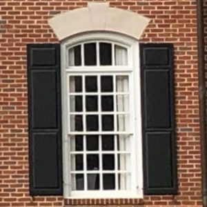

I have a love hate relationship with this very classic New England detail. It's expensive, super classy, not logical and lovely. There are variations, mostly involving the frieze and corner boards but the basics remain the same. And are often misinterpreted.
Another detail that immediately jumped out on the first "good" example, shutters that don't match the window. In this case they're a bit narrow, but more so being square shutters on an arched window.
Agree about the shutters, I didn't really notice them, I was using the window as an example of proper proportions. Looking at it they are pretty stupid. Thanks
Agree with Brian about the shutters,I thought this was going to be another 'bad' example. A European trade school would never accept the zipper coursing on the brickwork showing on this example either, resulting in a visually weak half brick spring point for the left hand arch. You say it's a historic house, is this veneer work or solid masonry? I suspect if the latter the masons would have known better and set up their openings to the brick perpends in the first place.

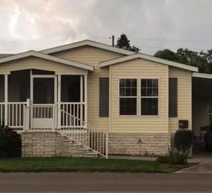

The greatest archi-torture detail I've seen in the past 20 years was on this home in Florida. Note the location of the "shutter-applique". Torturous on so many levels: function, size, beauty, common sense...
Is it possible the builder came that part of the house and said, "The design guidelines say that we have to have shutters on the front of the house...and, this is the only window. They don't fit NEXT to the windows...oh, wait, there's plenty of room back here. Perfect! Job well done!"
It's stuff like this that makes architect Bob Borson's (www.lifeofanarchitect.com) face hurt. UGH!
Chris, I think that is a double wide trailer with an upgraded skirt. It's called housing. Looks like a 3/12 pitch roof, consult thy speed square.

Typical warm climate manufactured home.

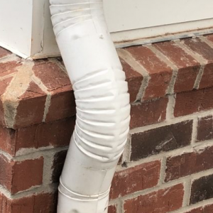

In addition to being ugly, wouldn't the brick ledge atop the foundation wall (with all those mortar joints) allow in a great deal of water behind the brick? I've seen renovation shows where people acknowledge that brick window sills are a terrible design choice for just that reason and recommend solid stone or concrete sills.

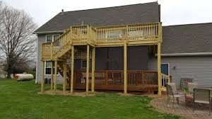

And, how about toothpick sized deck or porch columns?
Scott,
Back in the lat 80s we did a condo project in Ottawa where we specified concrete sills and caps on the masonry, but the developer substituted brick instead. There were problems within a year and a flurry of lawsuits. The insurers ended up replacing them all with the c0ncrete ones originally called for.
Scott - the brick foundation sill is not as much of a water trap around here as it is typically the facing on a poured in place concrete foundation. As long as the rowlock is sloped enough there won't be any water intrusion into the structure. It mostly just looks bad, as do toothpick deck columns. Thanks for the picture. This could become a great rouges gallery.

The unbraced deck posts would be illegal in NC and I suspect many other places. Tall deck structures fail in shear and people have died as a result

Functionally speaking, the pork chop is a waste of material. There's no reason for eave soffit venting to go past the house wall. There isn't any venting possible up a gable's ladder truss. Clipping the soffit back to the body of the house and letting the gable "fly" past would save material and cost. But the fillet of the soffit between house and eave looks weird because we've been looking at cornice returns for five hundred years. The pork chop is a short cut of added material that ignores historical precedent.

Carl, according to this article it takes less than 30 seconds for rain to pass through a brick veneer, so I would think having a brick rowlock would make things much worse, no matter how sloped it is (water running down the wall in addition to rain hitting the veneer at an angle).
https://www.buildingscience.com/documents/published-articles/pa-water-managed-wall-systems/view
WRT the foundation veneer in this pic this is often done when the veneer is an afterthought and I agree it is a functional abomination, creating a water table right at the most vulnerable point of the wall where framing meets masonry. I just want to mention though that a veneer of brick or stone on the outside of the framed wall plane can be a useful detail if it extends high enough to protect the the wood framing and siding from water damage when the exterior finish grade surface is high. Of course proper flashing details are essential, but these are much easier to manage when the abutment is elevated significantly above plate level. The second and third photographs are of a stone plinth course used in this way. Traditional craftsman homes commonly use this detail to create a wainscot course of brickwork up to window sill level or higher. It's visually very satisfying as a grounding connection for the home as well as a protection for vulnerable siding or as in this case stucco.
