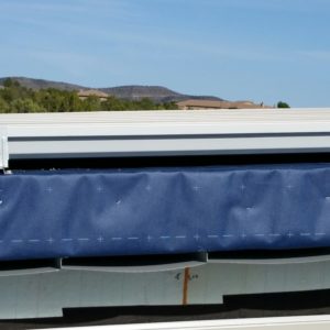

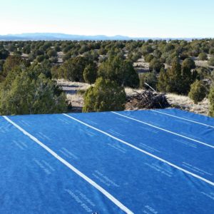

    I used SIGA Majcoat on my low slope SIP roof.
