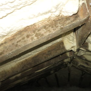

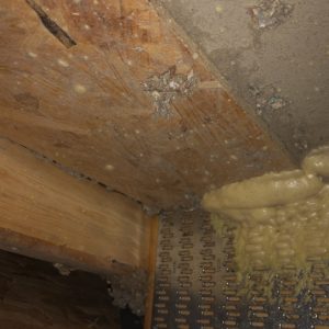

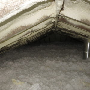

Actual Problem Case (Cold Climate)
An actual unvented/conditioned attic problem case I have seen was in Zone 6 (Maine), with ~2" closed cell spray foam at the roofline, and ~R-30+ left in the attic floor. This was a "what were they thinking?!" kind of case--I can't really explain the logic of the installer. As you would expect, the dewpoint in the attic was similar to interior conditions, and in winter, the surface of the underside of the ccSPF (and framing) were cold enough to cause condensation and mold growth. The moisture problem was solved by cutting vents back in at ridge and eaves. Unfortunately, it did not do anything to solve the air leakage problems at the attic floor.

Thanks very much for the comments and photos. This case shows that (a) methods that seem obviously risky to those of us who think about dew points don't necessarily seem obviously risky to many builders and insulation contractors, and (b) scenarios that seem unlikely are discovered all the time in the field.

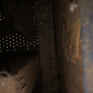

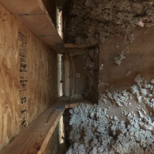

South Carolina modular 2nd story unfinished, and working on air sealing. Attached are 3 pictures of a somewhat cleared rafter bay. I also managed to take a picture of the soffit opening. I was wondering if I should attempt to air seal both cracks seen in the pictures. Also not sure why the builder placed OSB on horizontally on the drywall, but it had been foamed previously. Somehow the pictures didn’t orient properly, sorry. The 3rd is upside down.
My overall goal is to turn the 2nd floor into a living space and condition/insulate the whole area. 1450 sq ft total with a staircase.

Jonathan,
I assume you mean sound transmission from mechanical equipment, as the amount of insulation between you and the outdoors doesn't change, it just moves.
I'd suggest setting any HVAV units you are worried about of anti-vibration matts, which also attenuate sound.
