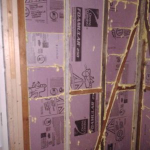

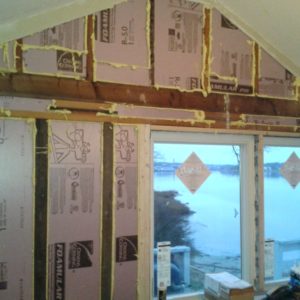

My own experience with cut and cobble
我have a lot of experience with this method of insulation. I think the pros and cons spelled out above are spot on. But if you're looking for an air-tight envelope on a rock-bottom budget, it's a viable option.
This describes my project and my experience insulating with salvaged polyiso.
http://www.finehomebuilding.com/item/23460/patricks-barn-insulating-with-garbage
我used a modified siding nailer to temporarily hold the insulation in the bays while I spray foamed the perimeter.
http://www.finehomebuilding.com/item/22229/patricks-barn-wrapping-up-the-exterior

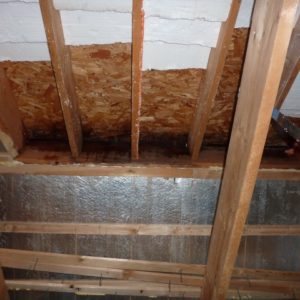

Cut and Cobble with damaged EPS
我live in the midwest and we just had some severe weather (maybe you heard). Good news for me is no one was hurt. Bad news for me is that about $10k worth of ICF blocks got damaged to the point where I can't use them for my foundation walls anymore.
So rather than throw them away, I was thinking about this "cut and cobble" concept. So this blog is very serendipitous!
我was thinking of trying to use it in my vented attic where I had originally been planning blown cellulose to ~R-60. My idea would be to cut pieces of it to fit between the trusses against the ceiling. With extra emphasis up against the heel. I thought that I wouldn't really need to worry about air sealing the cracks/gaps between pieces because 1.) the cellulose would (hopefully) settle into all the gaps/cracks and 2.) the air barrier will be the drywall ceiling with no ductwork or lights penetrating.
Am I missing something here?
Response to Robert Kohaus
Robert,
You can't depend on cellulose to significantly limit air movement unless it is fairly deep (maybe 10 or more inches above the rigid foam scraps). Cellulose is cheap, and I don't see any advantages to mixing EPS scraps with your cellulose -- and there are several possible disadvantages (for example, the chunks of EPS might prevent the cellulose from reaching the nooks and crannies where you want it, and your local building inspector or fire marshal might be unhappy if any EPS was poking up).
我would stick with 100% cellulose in the attic if I were you.

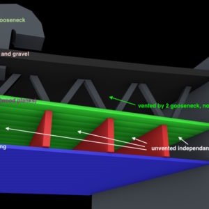

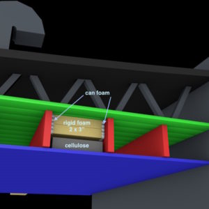

Another option?
我n another discussion on this site, installing full sheets of rigid foam on the INTERIOR side of the rafters (not between them) was mentioned. That would seem to avoid all of the cut-n-cobble disadvantages listed above, as long as you can live with the drop in ceiling height.
我n my case, I'm looking to foam a large unfinished attic for (a) its air seal advantages and (b) to keep HVAC equipment within the envelope. But I'm put off by the expense and odor/health questions. Am I missing something or do you agree that such an application is a great solution? Is there any reason the air gap (the full volume of the rafter bays) between the insulation and sheathing would be undesirable?
A brand new shingle roof was already installed, so exterior installation is not an option, but this seems just as good.
Thanks!

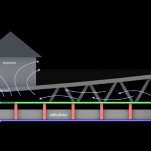

如果there was venting
从Kohta上野的评价高于未放气的assembly, what would of happened if there was a vent channel 1" or 1.5" from soffit to ridge. Wouldn't that have solved the issues and made it that the sheathing can remain dry and prevent rot?
Response to Dave Frank
Dave,
我f you want to leave your rafter bays uninsulated, and install a thick layer (or multiple layers) of uninterrupted rigid foam under your rafters, there is no reason why such an installation won't work.
Of course, it's important to list the usual caveats:
Pay attention to airtightness when installing the rigid foam. Use an appropriate tape at the seams.
Multiple layers of rigid foam with staggered seams are always better than one layer.
Make sure that the R-value of your assembly meets or exceeds minimum code requirements.
Don't forget to install a layer of gypsum wallboard to meet fire safety requirements.
Response to Todd Sherman
Todd,
Researchers haven't yet studied cut-and-cobble jobs, so we don't have much data on this type of roof assembly.
我f I had to speculate, I would guess that a vented cathedral ceiling with cut-and-cobble insulation would probably be less risky and an unvented one. But I'm guessing.
Remember, a vent channel between the top of the ventilation and the underside of the sheathing isn't a miraculous solution, and it can be hard to create such a channel (especially in roofs with complicated geometry, hips, valleys, dormers, skylights, or chimneys). For more information on this issue, seeAll About Attic Venting.

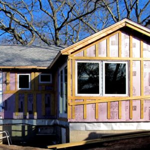

Cut & Cobble
我'm in the planning stages for a large addition on my seasonal residence, which I plan to retire to. My original plan was to install two 1" layers of staggered seam polyiso on the exterior and to install 5.5" of cellulose in the wall cavities, but this doesn't achieve the R-40 wall target I had in mind. Time and labor are not issues, as I plan to complete all of the work myself over about a 5-year period. Would there be any drawbacks/issues with filling the wall cavities with 4-5.5" of polysio using the cut and cobble method, along with the two 1" layers of polyiso on the exterior?
Response to David Tontarski
David,
我don't recommend that you encapsulate your OSB or plywood wall sheathing by sealing both sides with vapor-impermeable rigid foam. It's best if your wall sheathing can dry in at least one direction. I think that you should stick with cellulose between your studs.
Your proposed wall assembly has an R-value of about R-30, which isn't bad (as long as the house is located in Climate Zone 6 or somewhere warmer; in Zones 7 and 8, you'll need a minimum of R-15 of rigid foam).
我f you really want R-40, the best way to get there is to increase the thickness of your exterior rigid foam; I suggest that you install 2 layers of 2-inch-thick foam, for a total of 4 inches of exterior rigid foam.

Cut-and-Cobble worked well for this major remodel
We are nearly finished with a to-the-studs remodel of a 1950-era home on the Cape in Massachusetts. It was originally built with no insulation, so a complete upgrade was needed.
Major work started in November, when temps were too low to safely spray foam. With many changes planned to window and door openings, we also needed an incremental solution for insulation that we could install wall by wall. Cut-and-cobble was the answer. We cut XPS panels to fit each stud bay space, and carefully sealed the edges with the 'windows' version of Great Stuff, which remains flexible. This should prevent cracks as the assembly expands and contracts. A couple of photos are attached. With two layers -- 2" and 1" -- we could nearly fill each bay for a rough R value of 15 for the interior walls.
To boost insulation, reduce thermal bridging and block condensation on the sheathing, we also installed new housewrap over the exterior, covered by 2" of XPS foam board carefully sealed with Great Stuff. All of the panel joints and edges around window / door openings were also covered with a thick layer of flexible DAP 230 sealant. (For panel joints, empty a few tubes of the DAP sealant into a paint tray and apply it with a 3" paint roller. With pole extensions, it is easy to reach high up on your walls without a ladder.) A photo is attached.
我n short, the cut-and-cobble approach took more time, but matched the rest of our upgrades and project schedule. We ended up with ~R25 wall assemblies and a tight air seal. The next step: 8" of closed cell spray foam on the underside of the roof, which will create a 'conditioned space' attic.
One key tip: I discovered that Great Stuff Fireblock is actually very flammable, and ignites at just 240 degrees F. We used Great Stuff Windows to seal our XPS panels -- but switched back to standard fireblocking caulk to fill and airseal holes in studs and plates. This non-flammable caulk is required for commercial buildings, and -- in my view -- is the best fireblocking solution for residential structures too.
我hope this is helpful.
Mark

Cut-and-Cobble Insulation for my assembly?
我'm also considering Cut-and-Cobble Insulation for the 1924 - 1000 sq.ft flat-roof bungalow I bought 2 years ago. Attached is my actual structure, which has zero insulation right now (zone 5, brrrrr!). There is 2 sections over the ceiling, one that is unvented and level, and on top of it one that is vented with 2 goosenecks with no intake and has a slight pitch to drain the water in the center of the roof.
我figured the best way to insulate this roof would probably be from the top, adding 7-8 inches of polyiso, a deck and a membrane to cap it all, but that is expensive, and since the actual tar and gravel seem to hold up well, and that I planned to do intensive interior remodeling that will require the ceiling tearing, I'd like to have a from-the-inside alternative.
我f I tear down the ceiling (blue), I guess I could have the plank deck (green) sprayed with closed cell foam from underneath for R20, but I don't really like the idea of the whole chemical thing inside the house, even if I understand that the failure rate is very low (when choosing a certified contractor).
我then considered replacing the ceiling (blue) with a continuous 3inch of XPS under the joist, then a reflective / vapour barrier paper, then furring and gypse. The unvented sections in between each joists (red) would be filled with cellulose, leaving a 3-4 inches gap between the top of the lose-filled insulation and the plank deck (green). But I read several warnings how difficult it is to completely seal the vapor coming from inside the house, and since each independent sections would have no ventilation at all, the condensation risk on the deck (green) might be too great (?).
Then I read about the Cut-and-Cobble technique, which seem like a good alternative to the spray closed cell foam with less active chemical involved, and I could do it myself. I would install two staggered layers of 3 inch rigid foam in between each joist (red), right under the plank deck (green). Each rigid foam board seam would be taped, each sides would be sealed with canned foam. Then the rest of each cavity (5inch left) would be filled with cellulose at the same time the new ceiling would be installed, with no vapor barrier whatsoever so the assembly can dry from the inside (that is how I understand it anyway).
Am I on the right track here? Considering my actual situation, is this the best approach for a from-the-inside solution?
Thxs!
--Francois Desrochers
Response to Francois Desrochers
Francois,
The short answer to your question is that you have to follow the advice provided in this article:我nsulating Low-Slope Residential Roofs.
The longer answer would inform you that the type of ventilation shown in your sketch does not meet the requirements to ventilate a low-slope roof. You need a "doghouse" vent in the middle of the roof, and lots of air intakes at the roof perimeter.
Finally, the cut-and-cobble technique has been associated with failures (moisture accumulation) unless there is robust ventilation above the insulation. I don't recommend cut-and-cobble for this type of roof assembly.

Hey Martin
Hey Martin,
Ok, I understand #1 and #3, but about #2:
since the channels between red joist, below the wood plank deck (green) are not communicating with the above section, which is ventilated (poorly but still), do I need to improve the top section ventilation (doghouses) AND create some kind of openings in the wood plank deck (green) to help ventilate the below section, or the whole assembly will dry just as well?
我get that the deck (green) might not be totally air sealed in the first place, but would it be enough to dry any condensation happening on the underside of the cold deck (green) when moisture would actually hit it?
Do I need to create some openings between top and bottom section to help the air flow of the bottom section?
Thxs
Francois,
As I explained in my article on low-slope roofs, you have two choices: you can create an unvented assembly (an approach that requires either rigid foam above the roof sheathing, or closed-cell spray foam below the roof sheathing), or you can create a vented assembly (an approach that requires a central "doghouse").
我n my Comment #89, #1 and #3 referred to unvented approaches, while #2 referred to a vented approach.
There is never any reason to create holes in the green layer in your assembly. Airtightness is good.
我f you want to create a vented assembly, you need (a) a vented doghouse, and (b) adequate openings near the perimeter of your "attic" to allow exterior air to enter the attic.

Follow-up questions
Hey Martin,
so after much discussion with people around me, I have a some few follow-up questions if you don’t mind.
Concerning method #1, when you say:
1. Install closed-cell spray foam on the underside of the layer you have labeled "Deck (wood planks)." You can either install all of your insulation as closed-cell spray foam, or you can install a combination of closed-cell spray foam and fluffy insulation, as long as the R-value of the spray foam layer meets the minimum R-value required for your climate zone, as explained in my article on low-slope roofs.
Would the peanut-brittle insulation method you mentioned could be used instead? Or does it absolutely have to be closed-cell spray foam for the whole thickness corresponding to the required R value (for me, R-20)?
我f yes, when applying the peanut-brittle insulation method, let’s say for a 2’ x 8’ rigid foam board section, is the whole surface needs to be covered by the 1” inch thick closed-cell spray foam, or is covering only edges and seams sufficient (with a generous overlap)?
Concerning method #2:
2. Improve the ventilation details as explained in my article on low-slope roofs, and then insulate with fluffy insulation.
My understanding is that I should concentrate my air / vapor sealing on the ceiling layer (blue), underneath the cellulose, to minimize the air / moisture transfer from inside the house into the below section of my attic. Possibly using a class one vapor barrier?
我不应该做任何蒸汽比罗之间的密封w section of the attic and the top vented section of the attic, so whatever moisture that manage to go from inside the house to the below section, should eventually dry to the exterior / top section which ventilation has been improved with doghouses and openings on the perimeter.
All this is correct ?

More peanut brittle questions
我’d like to understand a bit more about the peanut-brittle and the associated risk.
The way I understand it, peanut-brittle method is replacing some of the volume of spray foam with rigid panel to save on cost, and seal the whole thing with an inch of closed-cell spay foam at the end.
我s it risky because of the shrinking and movement of the peanut-brittle layer underneath? The 1 inch of closed-cell spay foam isn’t enough to keep the whole thing properly sealed?
How risky it really is? Like risky-it-WILL-fail, or risky-it-most-likely-will-work but better options out there makes it a wrong choice?
Honestly, I’m getting more and more confused. None of the 3 methods you mentioned appears very attractive to me:
Honestly, we are very uncomfortable with the idea of chemical sprayed inside the house. We understand the vast majority of spraying done by competent contractor are going well, but there is an element of uncertainty that we would like to avoid.
Reading on the subject, it might prove to be difficult to achieve a good ventilation across our roof because of the poor access to the sides of the building. There is no soffit communicating, and the external walls are all brick.
我t is also difficult to find a local contractor that doesn’t look at you like you are an alien when you mention Doghouses to them. Most will just say to install 2 - 4 Maximum and be done with it, regardless of the missing intake.
3. Install rigid foam insulation above the roof sheathing.
This would require a new roof membrane (the actual roof is still in good shape), so it would be very costly, but also we aren’t sure how we would insulate the perimeter of the house under the roof sheating. All sides of building are brick wall in good shape. We could access the below-deck from inside, but the upper-deck would require the complete removal of the roof sheating from outside or cutting through the deck from inside. A hell of a job.
So the lack of a clear choice for me is why I’m pushing to find alternative methods, but those seem to just add to my confusion.
Thxs for your time.
Francois,
Ultimately, you are going to have to step up to the plate and make your own decision -- especially if you are resistant to my advice. That's fine. I can provide advice, but you have to make your own decision.
Q。"Is the peanut-brittle method risky because of the shrinking and movement of the peanut-brittle layer underneath? The 1 inch of closed-cell spay foam isn’t enough to keep the whole thing properly sealed? How risky it really is?"
A. I don't know how risky it is. I don't have a number. I have heard reports from people I trust of cut-and-cobble failures when the method is used for unvented roof assemblies.
我'm conservative when it comes to unvented roof assemblies, because there are lots of failures. Since I'm giving advice over the Internet, I take my responsibility seriously. I don't want to provide risky advice.
The safest way to proceed (if you want to insulate an unvented roof assembly from the interior) is with closed-cell spray foam.
我have also listed other options. What you do next is up to you.

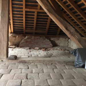

我nsulating Thin Rafters
我'm restoring a small 150-year-old stone house with a hip roof in France. It has a slate roof and no sheathing. The rafters are narrow (10cm X 10cm; about 3-7/8"), and the ceiling is low above our low second floor. I was considering this "cut & cobble" method of insulating covered with T&G pine for a ceiling. I'm thinking the rafters are not tall enough for batt insulation. Any ideas?
Response to Phil Jamison
Phil,
First of all, I envy you. I imagine it's a beautiful building.
Second, it's important for you (a) to comply with all local regulations, of which I am ignorant, and (b) to get local advice. You don't want to mess up a historic building.
Here are some basic principles:
1. From a moisture perspective, a slate roof is forgiving. It dries readily to the exterior after it gets wet. That said, it benefits from having an air space between the underside of the slates and the air barrier or insulation barrier beneath the slates.
2. Every insulated roof assembly needs an air barrier. You need to plan for an airtight ceiling. Remember that tongue-and-groove boards leak like a sieve. They are not an air barrier.
3. When rafters are too shallow to provide enough room for insulation, it's common to add extra framing members to increase the available depth. Some of these techniques are mentioned in my article,How to Build an Insulated Cathedral Ceiling.
4. I don't recommend the cut-and-cobble method. To reduce thermal bridging through the rafters, and to improve your chances of obtaining an airtight ceiling, you might consider installing multiple layers of continuous rigid foam on the interior side of the rafters, with the seams in each layer carefully taped with high quality tape.
Good luck. Below is a cheat sheet with French technical vocabulary.
L'amélioration thermique et énergétique des batiments résidentiels = Thermal and energy upgrades of residential buildings
La rénovation basée sur l’efficacité énergétique = energy retrofit work
l'étanchéité à l'air = airtightness
l'étanchéisation à l'air de l'enveloppe = reducing envelope air leakage (air tightening work)
pare-air = air barrier

Thanks for your reply and the French terms, Martin. Any insulation would improve this space. When the sun shines, it's hot. When the wind blows, cold. I describe it as a Tiny House (a term the French use, though they should say Mini Maison), heated with a wood stove. The very low ceiling in this attic (which I hope to use as a sleeping space) precludes lowering the rafters much. I'll let you know what I do.
Phil
Mini Maison
Phil,

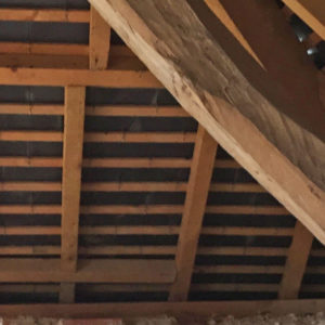

Show us more pictures. Everyone is jealous. The photo you should looks like a tile floor, and roofing that comes almost down to floor level. Is this the attic? It looks almost like ancient barn construction. I'd lover to see more.
You didn't mention what part of France, and what climate zone the house is located in. That makes a big difference.
An inch or two of cut & cobble insulation in the rafters would help, if you also include an inch or two of rigid foam insulation fastened to the interior of the rafters and taped as Martin mentions.
This would be relatively labor intensive with rough sawn (or hewn) rafters, but certainly a big improvement over nothing at all.
Response to Peter Engle
Peter,
椽子不似乎砍,虽然他们may be rough-sawn (see enlarged photo below). I'm guessing that the roof framing and slates are newer than the stone house. The rafters, skip sheathing, and slates look in excellent shape.

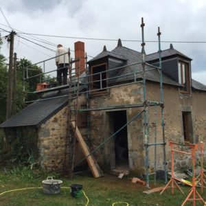

French Maison
Our house is in a small village in the Morvan in central France. I had the roof replaced about 15 years ago. The original was slate with under-size split tree limb rafters which were sagging under the weight. Before that, the roofs in this area were thatch. The contractor replicated the original look. Attached is a photo taken last year when we had the chimney restored. The second floor has enough height for me to walk along its center, and tapers down to about 16 inches at the eaves. When I bought the house (in 1991), access to the attic was by a crude exterior ladder. I added a small interior stairway. A long-time project!
Phil
Toute petite! Et si mignonne!
Thanks for the photo and details.
Martin

我figure a photo is worth 1,000 words. I was able to cut into an exterior wall (well, now it's interior due to a add on). From the outside in we have:.
1.) Stucco
2.) Wire
3.) Tar Paper (hard to see in photo)
4.) 1x10 Sheathing
5.) Kraft Paper
6.) Studs
我'm hesitant to place the foam board directly up to the Kraft paper/sheathing on the inside as in some areas where I've opened wall before there is evidence of the kraft paper becoming wet (presumably from the outside). From reading this article and a few others you've linked to I think leaving the air gap is the best choice. I plan on removing the old kraft paper as it's damp in some locations and the rigid foam should replace it's function.
Then my final solution would be:
1.) Stucco
2.) Wire
3.) Tar Paper
4..) 1x10 Sheathing
5.) 1/2" air gap
6.) 2" rigid polyiso foam
7.) 2.5" rockwool
8.) Drywall
9.) Paint
Does this seem like a good plan of action given that I don't intend on removing the exterior stucco?
Thanks,
- Chris
Chris,
我f the kraft paper is getting wet, you have evidence of a flashing problem. If I were you, I wouldn't engage in any air sealing work or insulation work until I had identified the source of the water entry problem and corrected it.
Fixing water entry problems (flashing problems) always happens first -- before anything else.

是的,我们有一个老虎也创造了2山谷ys. The 2 pictures above are of the same area (sorry, should have clarified!). All in all, I count around 20 rafter spaces involved in this part of the roof that don't lead to a soffit vent - all of them, however, lead to the main ridge and the dormer ridge. The rest of the rafters throughout the attic all go straight down to the floor and open to the eaves where (some) soffit vents are located - as I mentioned before, the plan would be to eventually install a continuous soffit vent for all of these rafters. This conundrum area around the dormer makes up about 1/6 of our attic, maybe less. Correct me if I'm wrong but I've read through many of your articles and many, many comment sections and have seen you suggest a hybrid approach to some individuals that find theirselves in a similar situation - which is why I considered this and asked you in the first place.
Are you saying that because of this one dormer / valley section of the attic, we must spray foam our entire roof? If so, then I suppose we'll reconsider our options. Otherwise, if there is a chance to approach this as a "partially-mostly-vented roof" then I am still curious about the questions I posted above.

Martin, I asked this question generally about my re-insulation of a 4:12 shed roof while re-roofing with metal standing seam (so on top of plywood will be hi-temp ice and water shield)//m.etiketa4.com/question/insulating-shed-roofand got some feedback. There is currently venting which I want to maintain and I am hoping to maximize the R-value but I cannot add foam on the top of the sheathing and am leery of full closed cell spray foam. For a lot reasons I've decided on cut and cobble (trying to do this myself and save money, have the time and patience to get the details right, etc.). In short, I have 2x10s with about a 16' span. I will place 3 layers of 2" polyiso and a 1.5" layer. I will rip them to fit the 16" o.c. rafter bays. I will maintain a 2" vent channel soffit to ridge. A few detail questions:
1) On the forum thread, an expert member suggested (and you do in the article) that with the vent channel, the stakes are lower. Will it be acceptable to meticulously edge foam and caulk the first layer (set on top of ceiling drywall) around all sides and at butt joints but subsequent layers can be cut to size and set in place without much or any foam/caulk? Or should every layer be sealed?
2) I have a Great Stuff foam gun--is there a preferred foam for doing this? The gaps/cracks? The window/low expansion? Would a tighter fit and a really good flexible caulk (such as OSI QuadMax) be preferable? Foam the perimeter, set first in place, then caulk the top of the panel perimeter?
3) Does it matter whether the polyiso has a foil face or a kraft face? Is it fine if all four layers have the foil face? (I've been surprised, in the DMV area, how difficult it is getting polyiso boards and I can't be too choosy).
我nterestingly, the current assembly, that is "vented," has the full 9.5" inches stuffed full of fiberglass. The areas I saw (due to a branch that had punched through) in the middle of the rafter span, were bone dry and had no signs in 50 years of moisture buildup.

亲爱的马丁,我想回来,谢谢or the guidance and advice (and thank a few others in the Community Q&A). Your wisdom gave me the courage to pull the trigger and get this project done in August. I probably was "worrying too much" but most of the articles you wrote about this started with images of rotten roof framing, so I stand accused. Anyway, I tore off the shingles and proceeded to remove two pieces of plywood at a time (I got a denailer gun and wow did that make the plywood removal safe and easy). The bottom row of plywood had actually been replaced previously and had an intact ice/water shield on it. Given the 2.5 overhang, and given the fir plywood I was using was back up to $70 a sheet, I left that row in place and just nailed to code spacing. With two sheets removed in a staggered pattern, we worked to clean out the cavity of the old poorly installed fiberglass, ran a bead of spray foam around the edges, placed a 1.5" piece of polyiso cut to width (found it worked best to have a bit of play, so cut them 1/4" narrow), then spray foamed and repeated for each layer, with a total of one 1.5" and three 2" pieces. That gave me 7.5" of polyiso with air tight sealing the whole depth. I also then was able to maintain the 2" air channel above that, under the new fir plywood (that then got hi temp ice/water shield and the metal roofing assembly). By working on two sheets removed at a time, I could get three full rafter bays done, and prep the lower or upper half of the next one. We would then replace a sheet that covered half of the just completed rafter bays and half of the previously done. We just kept pulling off one sheet at a time and replacing a sheet one by one until we got to the end, and that way we had solid surface to do most of the work (there were some I had to straddle and reach, but not many). As for venting, it turned out that while I had eave and soffit venting (on this shed roof), the builder had installed solid full depth blocking right up the middle, so there was no effective venting (!). Regardless, there was no sign of any moisture problems. I removed the upper 2" of the blocking (drilled holes and then chiseled in between) to create a full channel from bottom to top. At the bottom, we started the insulation over the wall plate and terminated the insulation on the outside of the top wall, so both plates are now under the full depth of insulation.
我n the end, it was two pretty grueling, hot, tough days, with my three landscapers helping me (yeah, yeah, landscapers, but they do what I ask them, they work hard, they don't complain). But we got it done, the roof is super solid (5 ply fir nailed properly was way stiffer than the 3 ply that was on there previously).
The results were instantaneous. On the hottest summer days, my a/c actually will cycle off occasionally and I experience no temperature gain (I used to struggle to maintain 3-4 degrees above my set point). My energy bill dropped about $150 the last two months of the summer and my run time of the a/c went down by about 35%. My only challenge now is that because the a/c is cycling on and off more, the relative humidity in the house was up around 75%. I will get a dehumidifier for next year to run full time to draw out some of that moisture. So thanks so much!
